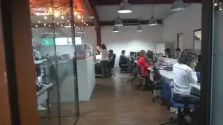

Here in the office we suffer a lot with static shocks, all day long when people touch each other, open a door or grab a coffee. It's really a pain.
This is what the office looks like:
Office picture
We have A/C on. Air humidity ranges between 40% to 50%. Outside temperature is around 28ºC and indoor temperature is around 23ºC. I don't know if it matters, but the floor is some sort of fake wood layer. I don't know the material.
I don't know what else to say. We have a lot of computers, no-breaks on the floor and electronics devices.
What can be causing these shocks, and how can it be prevented?

  • The windowed meeting room (??) on the left of the picture has a metal frames that reach the floor. Touch those as you pass by.

Weather conditions, physical activity, and modern building materials work together to zap us.
Probably, the main problem is the floor material unless the floor is specially formulated polymer flooring used to control static electricity build-up. Almost all shoe soles have rubber and polyurethane composition. When the shoe soles move across normal laminate floors, a static charge is generated.
The laminated floor, chairs (wheels, upholstery, trim), desks, walls (alkyd or latex paint), and ceiling (alkyd or latex paint) are plastic composition which increases static electricity build-up. Glass walls can also increase static electricity buildup.
Increase the humidity to lessen or prevent static electricity discharges. Get some large floor plants into the area.
You might also try application of staticide by the cleaning crews during nighttime cleaning and maintenance.
