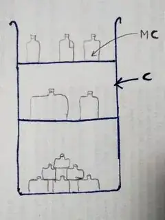

I run a milk-delivery company, using vans to delivery cans and gallons of milk around my county. The milk cans (MCs) are loaded in the metal cart (C), with each level of the cart for different delivery destinations. The front view of the cart is shown.
Front view of cart
When the van is moving around and swerving, I have a constant issue of the cans falling off. What is the best way to put straps (my current idea) across the front to prevent this from happening? Should I put them top to down, or one across each level, or criss-cross? Are there better ways to prevent this?
I chose straps, since they give the ease of removal of cans without wastage of time to open doors or such other solutions.

Straps are a good idea. Run one horizontally across each level, at about half the height of the cans.
The traditional solution (used e.g. on ships) is to put a strip across the front of each shelf. You just need to make sure the shelf is packed full: if the milk cans can slide around on the shelf they may build up enough speed to fall over the strip.
A better solution would be to build a grid on each shelf: place strips of wood on each side of each bottle so the bottle can't slide around even if it's the only one on the shelf.
Something like this, but with the dividers at the correct distance for your bottles:
As an alternative, you could use bottle crates instead of these carts.

  • Thanks for the answer! The issue generally happens when some deliveries have happened, and some remain. The half-empty levels get messed up. Also, by crates, do you mean structures that are closed in the front? That just reduces the speed, making it slow to remove a can at each stop. – Raj Jun 13 '17 at 16:51
  • I've added another idea and some images. – Hobbes Jun 13 '17 at 17:38

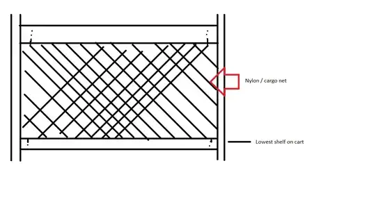

For stacked goods, you have the option of combining the mats with straps or a net for added support. For this I have considered the option of storing the straps/nets in the cart itself, to avoid these tools getting lost.
This allows you to stack your milk cans almost as you please on the two lower levels.
Option 1
If your cart has wide lips on each shelf (like a standard steel kitchen cart), you can drill a number of holes in each lip. Fit a suitable net with metal hooks that fit in the holes. When transporting stacked cans, the nets are stretched between the two shelves like in the picture above.
When not transporting stacked goods, if you leave extra holes for the hooks, you can store the net underneath the shelf above.
I suggest this if hygiene is important, as the nets can also quickly be unhooked and cleaned if needed.
Option 2
Mount curtain rails on the shelf and under the shelf above, and mount your net to that. When not in use, the net is pulled aside (like a curtain), and it can be pulled closed when needed.
This is, however not so suitable for hygienic applications, as you'll be adding addtional nooks and crannies to the cart.
Option 3
Use one large, flexible net (fitting the size of the shelf), and use large lobster clasps (fitting the size of the cart supports). Drill holes at different levels in the cart supports, and fit them with screws/bolts/pins to hold the clasps securely in place.
Make an additional "storage" pin at the top of the shelf, where the net is stored.
When needed, simply pull the net down on the cargo as tight as you please, and fasten it to the locking pins needed.
You can use a standard flexible cargo net for cars for this option.
