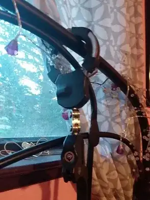

I accidently locked a master lock Street Cuff to our bed's headboard. The funny part is I lost the keys to unlock them. The headboard does not come apart.
Any idea to get it off besides using an angle grinder?
In YouTube, I could see one guy figuring out how to pick this kind. He does not live nearby.
I know it looks kinky, I actually put it on as a joke but my wife pressed the lock button without knowing it.
It is been there for 2 years. Any advice or hack is seriously appreciated.

  • What kind of key mechanism does it have (usual cylinder with pins or tubular key or...)? Masterlock is known for fitting the lock cylinder with straight, smooth pins (the cheapest ones), and some people can pick them faster than they can open the package containing a padlock. Locks not intended for high security applications (as the one in question), may be specially insecure. I would suggest calling a locksmith (if you don't want to spend the time to learn to pick locks yourself). – k-l Jan 16 '17 at 02:29
  • It's a tubular opening like a kryptonite lock, but made a few generations after the Bic pen cap trick. The guy that picked it used 2 tools, he wedged the circle down then manipulated the mechanism around. – Webster Jan 16 '17 at 03:02
    Likely not to work but almost free, cut a bit of cardboard and bend it into a tube, press the tube into the opening of the lock and turn, as if it was a kryptonite key. (It did work on a long series of expensive bike locks.) – Willeke Jan 16 '17 at 20:38
  • why do you feel the need to explain yourself? it's not our business what you are or aren't into with consenting partners. – user371366 Oct 03 '19 at 01:59
  • Lol because it looked kinky. I got it off a couple years ago with large bolt cutters. – Webster Oct 03 '19 at 05:26

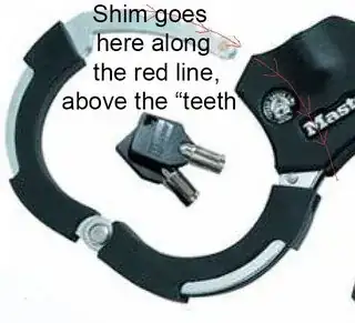

If they use a ratchet type of closing (like a hook/sheer that latches) there's a really good "drinks can" hack that you may be able to try similar to this How to make a Simple Lock Shim
Edit in response to Willeke's comment.
The basic process involves cutting and shaping a thin, sturdy, sheet of metal (a shim); which can be obtained "carefully" from cutting an aluminium drinks can, you can also buy shim from engineering suppliers/online; these are normally made of brass and may be too soft for some locks (the same with aluminium). If you find these metals are too soft, try some steel shim instead. Be aware, these metals aren't kind on ordinary scissors...
The premise is that you cut the shim to size, and then shape it accordingly so it can slide inside the opening between the bar that goes into where the locking mechanism is, and, the case that houses it. With enough force (care with sharp edges), the shim slides between the "bolt"/"sheer pin" (sometimes a ball-bearing), that is part of the lock internals, and between the movable bar that allows you to open and close the lock around things.
This is much harder to describe than picture :D
If this works with those cuffs... I've never "reverse engineered" them before...
MasterLock Street Cuffs
There are also other items you can use to slide between the housing and the movable locking bar depending upon the type of lock you have. Being unable to see the type or style of lock that's in the Questioners' post, I am unable to determine the best route to take. However, ZipLock ties, (plasticuffs), and old style handcuffs can be bypassed in a similar fashion by sliding something between the "sheer" and the ratchet-shaped surface.

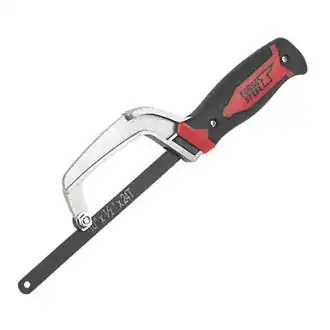

Other than that, I would recommend a "Junior Hacksaw". or a "mini-hacksaw" like this pictured: "Mini-Hacksaw" (ok, apparently I need 10 rep to post more than two links!) Thanks for the rep :) )
Mini-Hacksaw

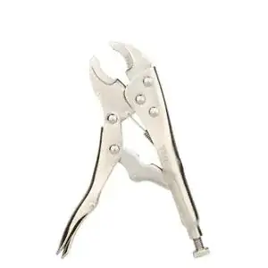

And! Hold the lock as sturdy as possible with an adjustable wrench, like this one, you want all that arm energy going into the cut, not moving everything about :P : "Adjustable Wrench"
Edit: I have been a hobby lock-picker for years. The time and effort involved in sourcing picks and trying to learn without breaking a lock, or breaking/damaging a cheap pick (I use Southord), you might as well just hacksaw it off considering hacksaws are cheap in comparison. Depends how much the cuffs were? but yes, time and effort, go for a hacksaw if it can't be shimmed...

  • Did you see the comments on the answer given by Topher Brink on this question, where it is stated that this lock is a "tubular cylinder", which can't be shimmed? This kind of renders your entire answer useless for the OP. – holroy Apr 15 '17 at 17:16
  • @Timeless, thanks, that is a real answer. (Even though it seems to miss the point as is pointed out in the other comment.) – Willeke Apr 15 '17 at 19:55
  • @holroy - Shame I missed the comments on the OP, that would have been 3am here... Oh well.. I tried! :D –  Apr 16 '17 at 07:49
