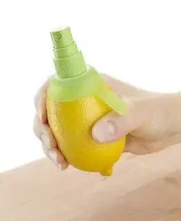

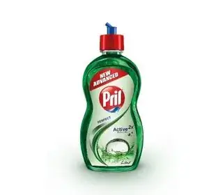

I suggest you follow these steps:(During these process, please check fridge is not working)
  • First, you can remove the meat from fridge to a trash bin or to a carrier and then, trash bin.
  • You could search in the kitchen to find out a dishwasher like this. I suggest you have the one that is strong in odor.(I am not branding product, please find a substitute in your local market)
  • Take some drops of it in a container, add some water and dilute its concentration.
  • With a clean cloth, dip it in this solution and apply it to space in the fridge where the meat was kept.
  • Let it dry for few minutes. -You could use a dry piece of cloth to wash that applied solution away.
  • Even after this, if the odor exists, then you could use the lemon spray as shown: enter image description here
