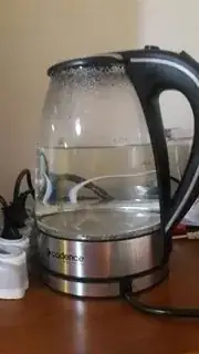

Does boiling tap water make it potable? If not, are there other ways (lifehacks) to make it potable without a filter? I saw a related question here on lifehacks, but it only adresses the taste, the answer did not specify if the boiled tap water would then be potable, risk-free to be drunk. I use this boiler, in case it helps:
water boiler

To answer the question directly, the answer is an emphatic No.
If there is something 'wrong' with the water to start with, then simple boiling in a kettle will not 'fix' it.
It will not fix:-
  • Chemical contamination in any way, shape or form.
  • Biological contamination - though it will kill a lot of biological contamination it is not 100% certain.
You can improve your chances by many methods, but not with only a kettle.
Having said that,
  • if the water came straight from the tap in pretty much any "developed" country, then it's potable right out of the tap.
  • if it came from a well, stream or lake, then you cannot guarantee it to be potable.
Processes to 'clean' water, but require more than just a kettle:-
  • Sterilisation does not remove chemical contamination
  • Distillation can remove some, but not all contaminants.
    Anything that will boil off at a lower temperature than the water will move across with it, unless you have a fractional still [far too much to explain here, but some general info].
  • Reverse Osmosis - allowing 'pure' water to pass through a semi-permeable membrane; a very complex process not normally done as a single stage, but also employing additional chemical &/or bacterial filtration.

From this link to REI
Boiling is not going to remove heavy metals or other toxic chemicals but a filter is also not effective against most heavy metals or toxic chemicals.
Your stove, fuel and a pot are an effective treatment system to combat the full spectrum of biological pathogens. Bring water to a rolling boil for 1 minute; if you’re above 6,500 feet, boil it for 3 minutes.
Pros:
The only additional supply you need to pack along is extra fuel. Murky water doesn’t impair effectiveness. Serves as a readily available backup method in case your main filter breaks. Cons:
Time and effort required to bring water to a boil. Wait time for the water to cool. If it’s your primary treatment method, you need to pack an extra fuel container.

Yes and no.
Boiling water for a minimum time (I recall it as ten minutes, but I could be wrong) will destroy any biological pathogens (bacteria, viruses, parasites) in the water, but will not make the water chemically safe if it wasn't before boiling. If you suspect your water is contaminated with toxic chemicals (lead, cadmium, perchlorates, petroleum seepage, etc.) you should use a suitable filtration system to remove the toxins.
You may also want to boil the water if there's reason to suspect bioharzards, but most high quality filters will remove bacteria and parasites as well as dissolved chemicals. Read the labels to be sure.
