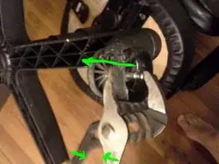

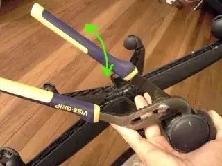

I used a 9" channel-locks pliers, which fit perfectly between one wheel and the leg frame. Carefully [edit: Aggressively - thanks Tetsujin!] pry from side to side until one wheel pops off. This will do some chewing on the frame and the inside of the wheel, but these are not visible areas. Don't be afraid of breaking. This is tough ABS plastic, and if the clog is bad enough you'll do it!
Pull the roll of hair off the exposed axle. Now instead of prying the other wheel off, pop the whole axle out by closing the pliers and pinching the end of the axle towards the other side of the frame.
Pull the other roll of hair off. Reassemble.

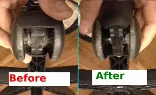

Here's the before and after. I did two chairs, each with five casters. Nothing broke. Second one took 7 min. total. Very satisfying.
