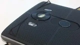

In every smartphone I've looked at, the camera protrudes slightly from the bottom of the case, meaning that it is the primary point of contact when the phone is laid down flat:
Phone camera demonstrating the protrusion
Note that the lens itself is surrounded by a metal ridge, but it is at most recessed by a millimeter, which is a bit close for my comfort. This seems like it would be trivially fixed by addition of small ridges near the camera that would raise the camera portion up 2mm off the table. Unfortunately, this has apparently not occurred to anyone anywhere, and they don't even sell replacement back-panels with this feature, as far as I can tell.

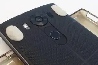

My first-order solution to test that these ridges would work is to take some gummy tack and stick it on the top of my phone, and it effectively demonstrates that a very thin, low-profile ridge can effectively allow you to place your phone face-up on a table without issue, but it violates pretty much all three of these rules, and it's sticky to boot so it accumulates little fibers:
Phone back with gum-tack stuck on the back

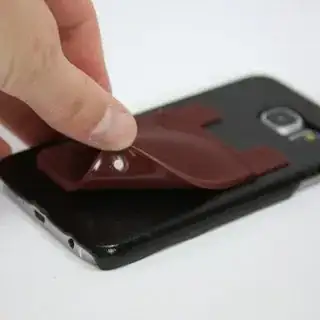

For something that looks less like a hack job, a "phone wallet" sticks on to the back of a phone and allows you to put in an ID, RFID transit card, credit card, or whatever else you want to put there, and this would add some thickness in a large, flat surface that could be the primary point of contact when the camera is laid flat. This might provide some of the extra thickness you seek, without a 1:1 increase in net bulk of stuff in your pocket.
Most of these stick on with various gel-like or sticky surfaces; some of the more flexible or silicone-style ones would probably fit into the textured surface better than the more rigid ones.
Branded versions of these are commonly used as corporate giveaways (online example here). You can purchase some custom items for your giveaway here (credit as image source; I have no direct experience with any firm mentioned in this post).

  • I think black duct tape might work ok. The pocket thing doesn't seem appreciably better than a case, but I might be able to just cut off the top part and attach it – Paul Aug 24 '16 at 02:00

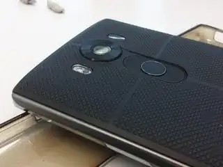

A quick sketch based on your original photo...
