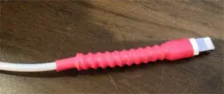

The connection between the wire and the connector is a very high-stress area, so the degree of flex the wire experiences at that point is substantial. Better-quality cables will typically include a rubberized extension along that connection to spread out the load, but if that does not solve your problem, you can make a more substantial reinforcement yourself.
You can use heat shrink wrap tubing to build a longer, more-flexible reinforcement.
If you want to get really fancy, add a pen spring before you shrink wrap it to make a really strong, flexible connection.
If you don't have shrink wrap on hand, you might want to invest in something like this product called Sugru (product search). Sugru is a moldable/shapeable, self-setting material that turns into a strong, flexible, waterproof rubber overnight. It's more expensive than shrink wrap, but you can use it for fixing, modifying, and making many things that are broken or need this type of modification.
