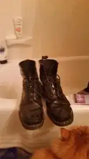

I have a pair of Dr. Marten's boots that have just worn-in in terms of starting to feel good on my feet. Structurally, I expect to get a few years of life out of them.

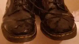

But, they're the patent leather, and the toes have suffered the normal "Dr. Marten's damage" that a work shoe usually gets. But the visual effect is pretty excruciating ... to my mother!
zoom
What can I do to make these "Sunday appropriate"? Cuz they're not coming off of these feet until 2017 to fit my shoe budget.

This is a simple procedure but it’s not easy and will take some time to undo the damage already done to the boots. When you’re finished, you’ll have a mirror shine. This is the technique used for polishing boots for a military dress inspection.
You will require very fine sandpaper, clean polishing cloths (clean cotton dusting rag) or cotton balls/wool/etc., boot polish, a small bowl of water, a shoe brush, strong motivation, and a generous amount of elbow grease.
  • Remove the laces.
  • Carefully remove the material that has torn and lifted. Trim the edges near the surface without pulling off the enamel that still remains attached to the boot. A pair of small scissors may be helpful. Normally, one starts with boots in slightly better condition.
  • Smooth the rough edge with the sandpaper and try to make it as even as possible. Try not to remove much material when doing this. You want to make the surface look more normal than they do in your photos.

  • This is excellent information. I'm sure to use this for reference later. Unfortunately for this pair, I went with the black duct tape. I expect the tape will peel and look horrible in less than a few months. So I'll need to start with adhesive solvent, goo-gone, and probably alcohol to get ready for step 1 here when that happens. There is also a small tear in the upper of one (now covered by tape), so I'll use something like "ShoeGlue" to seal that before adding polish. – luser droog Aug 24 '16 at 15:41
Maybe you can refinish your boots.
Most likely, your boots were made with Leather Luster. This is a product that you paint on to the boot and allow to dry. It's a kind of enamel paint. This will give you an almost "instant" mirror finish with low maintenance. However, this finish will crack (as you've discovered) and will be next to impossible to remove. It should only be used on surfaces that will not bend.
If you remove the residual loose finish, you can get and reapply a new coat on the damaged parts of your boots.
