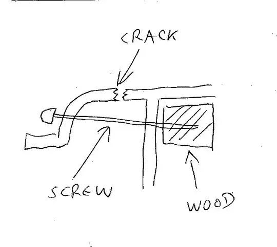

I have repaired similar plastic items (in my case, a compost-holder) by pre-drilling holes and driving woodscrews into a suitably shaped piece of wood somewhere behind it. Your picture is not too clear, but here's a sketch: screw and wood Don't use a countersunk screw, that would probably split the plastic. This will give you a stable mechanical basis which you can then waterproof with whatever is convenient (silicone perhaps).
Success!
NL_Derek
  • 294
  • Thanks. It looks like this won't work for the specific geometry of my lid, but it's a good idea in general. – alexw Mar 01 '16 at 15:47
