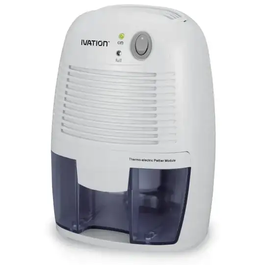

You can get a portable dehumidifier. It doesn't cost that much. I have one and it works well for a single room. The one I got is this Ivation dehumidifier from Amazon
It looks like this: enter image description here
Turning on AC in the summer and turning on furnace(electric heater) in the winter also helps reduce humidity in the room.
