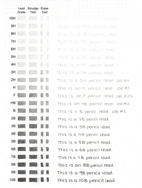

Big fan of pencils for both office & study as well as sketching & artwork. Different erasers are designed to work with your particular pencil and paper selection, so there are a few issues to consider.
Graphite Hardness and Erasability
At the bottom of this post, I included a pencil grading test to show the effect of graphite hardness on how a pencil writes and erases. Generally speaking, softer leads are easier to erase, but they are also more prone to smudging (left-handed pencil users sometimes prefer harder leads for that reason). Harder H-grade leads are more smudge-resistant and give cleaner lines, but they tend to be more scratchy on the paper and are harder to remove once applied heavily enough to be easily legible.
The sweet spot between legibility and erasability is somewhere around the HB to 3H range (HB is your #2 pencil in the U.S. grading system — Graphite Grading Scales Explained). 2H is dark enough to be read clearly with minimal smudging while being easier to erase and correct mistakes.

Pencil Lead Hardness Test
pencil lead hardness test

  • From my one-sided question, you managed to show me there's more to it. As you said, the shields are more than what I need, but I will have more attention choosing my pencils now. I've been using HB, but I had a 2H here and gave it a try, with much better smudging results but still readable. Since there's nothing I can do about aging erasers, I'll consider buying smaller ones, to use all of them. Great sources too! Just a question: you said "2H [being] your #2 pencil in the U.S. grading system", but that would be HB, right? – bandrade Dec 31 '15 at 13:52
  • @bandrade The tl;dr version is try the Uni Mitsubishi 9850. With the good lead and the matching high-quality eraser, it should fill your needs. And yes, the #2 lead is HB. With the different grading systems, it gets confusing which is which. Corrected. – Robert Cartaino Dec 31 '15 at 15:07
