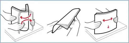

Just before printing, remove the paper from the printer and fan it to prevent the paper from sticking. One of the sources I reviewed said that in an arid environment, fanning could cause sticking due to a build up of static electricity.
Grab one end of the paper with one hand. Grab the opposite side with the other hand. Bend the paper (without causing damage) so that an arch is formed. Using your thumb (either hand will work for this), release that side so that the paper is allowed to separate.
Picture showing how to fan the paper Image from Lexmark
