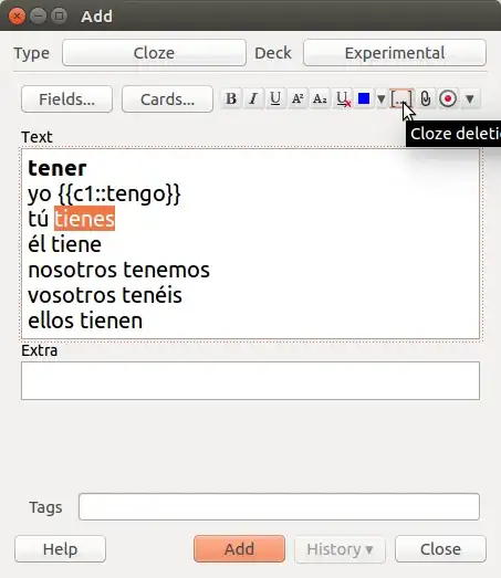

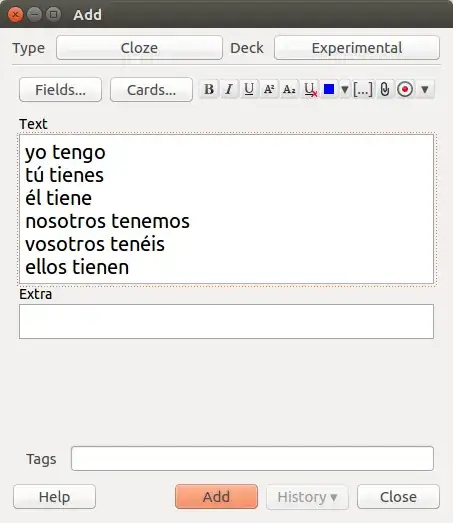

For example, you start with the form for the Spanish verb "tener" (simple present), copied from a conjugation website:
Anki's Add card dialog with the six forms of tener in the simple present
Then, one by one, you transform these verb forms into cloze deletions by selecting each form and clicking on the [...] button:

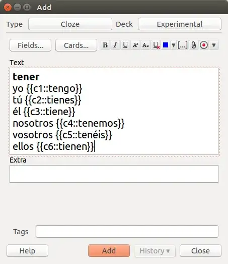

When you're done, each of the cloze deletion fields has a different identifier, namely c1 to c6: The same dialog as above, but now with all verb forms converted into cloze deletions

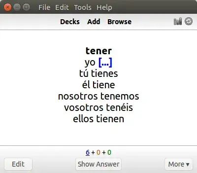

This results into six cards, one for each form, so when you start reviewing the verb "tener", all forms will be visible, except for the one being tested by the current card:
Review dialog with all the simple present verb forms of 'tener', except for the first person singular, where a cloze deletion is visible
