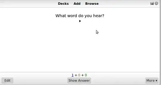

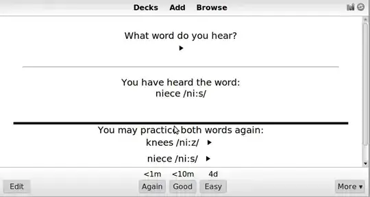

Now you are ready to add new notes and train. This method is based on this excellent post.
Example of how it should look in practice:
