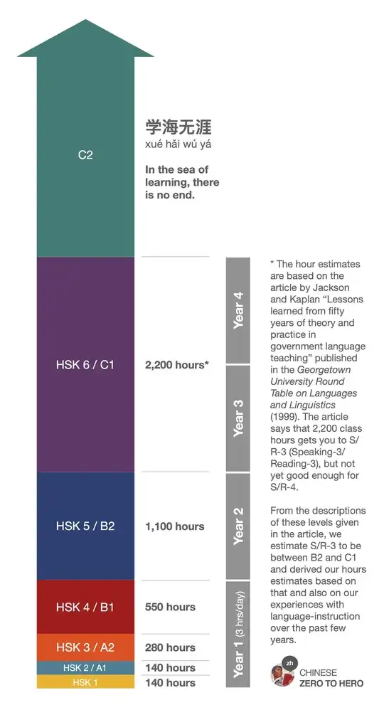

The timeline I've been using is this one posted on Reddit (HSK 2.0 standards) by Chinese Zero to Hero:
Chinese Zero to Hero's timeline; HSK1 140 hours (1/8 year); HSK2 140 hours (1/8 year); HSK3 280 hours (1/4 year); HSK4 550 hours (1/2 year); HSK5 1100 hours (1 year); HSK6 2200 hours (2 years)
This is largely consistent with my study. E.g. I passed the HSK5 in July 2021, and I'm still yet to pass the HSK6. Multiple people in the Reddit thread have agreed that it matches their experiences.
