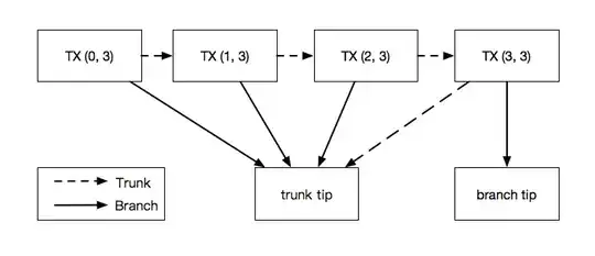

A visual representation and more in-depth-explanation can be found in this blog post:
https://medium.com/@louielu/in-depth-explanation-of-how-iota-making-a-transaction-with-picture-8a638805f905
visual graph
instantlink
