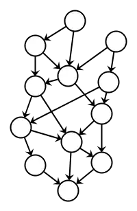

This is our main tangle:
tangle

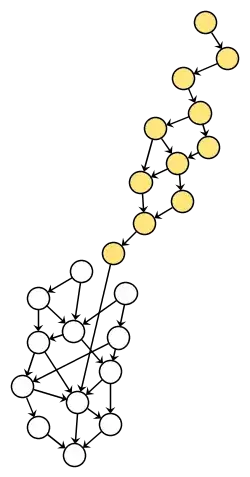

When you start a subtangle you are going offline. You no longer know which new transactions other people/devices make and other people/devices no longer know which new transactions you make. But the tangle you stored when you still were online will remain in your memory.

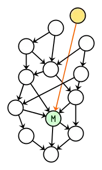

You should start your subtangle at a transaction that has already been validated by a lot of transactions or today, with the COO, at a milestone or transaction validated by a milestone.
c-start

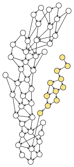

When you want to reconnect, you broadcast all transactions in the subtangle to the network.
c-reconnect
