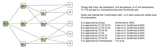

The probability for a transaction to be valid is equals to the proportion of tips validating the transaction (directly or indirectly). I created some illustrations to explain how a double spend is detected. Let's start with a tangle without a conflict: 5 tips no coordinator; no conflict

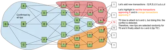

Now if you introduce conflicting transactions (X and Y) in this tangle we will have this : same tangle with a conflict

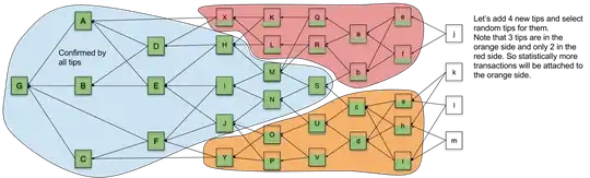

When we add more transaction, the conflict will be detected and kind of split in the tangle will occurs: split tangle after adding more transactions even more transactions

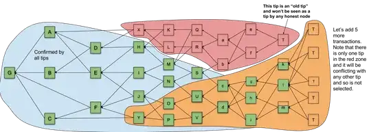

And the split will be resolved by eventually making the red part orphan. even more transactions; one side "wins"
In this example, the tangle choose Y as valid, fundamentally this decision was random, but once this decision is taken it become practically impossible to revert it.
