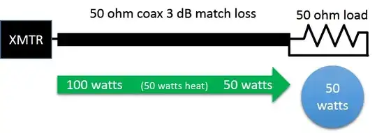

First consider a feedline that has a 3 dB matched loss connected to a 100 watt transmitter. We can convert dB loss to a percent loss:
$$\text{Percent Loss} = \frac {1} {10^{(L_{dB}/10)}}*100 \tag 1$$
where LdB is the loss in dB form.
This means that when the 3 dB matched line is terminated in its characteristic impedance, only 50% of the transmitted power (50 watts) will arrive at the antenna end of the line and be aborbed/radiated by the load. The other 50% has gone up as heat in the coax.

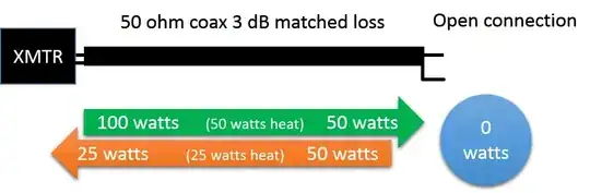

Now instead of a matched load, let's consider a most extreme case of leaving the far end of the coax cable open. In this condition, 100% of the power arriving at the open end is reflected back towards the transmitter. As before, only 50% of the transmitted power (50 watts) arrives at this open connection. This is now fully reflected back toward the transmitter. But just as the forward power was attenuated, so is the reflected power by the same percent. So only 25 watts arrives back at the transmitter.
We can now calculate the SWR at the transmitter:
$$\text{SWR}=\frac{1+\sqrt {P_r/P_f}}{1-\sqrt {P_r/P_f}} \tag 2$$
where Pr is the reflected power, Pf is the forward power.
The SWR at the transmitter is 3:1 in this example. Quite an amazing transformation of an infinite SWR at the far end of the feedline but it comes about as power dissipated in the coax.
Now let's generalize the example by creating an equation that allows us to calculate the maximum SWR at the transmitter end based on the matched line loss. Note that in the open end example, the power arriving back at the transmitter was attenuated twice. We can represent this as the square of the loss (i.e. loss times loss). Then if we use equation 2 but normalize the transmit power at 1 watt, the lower Pf factor goes away. This leaves us with the following:

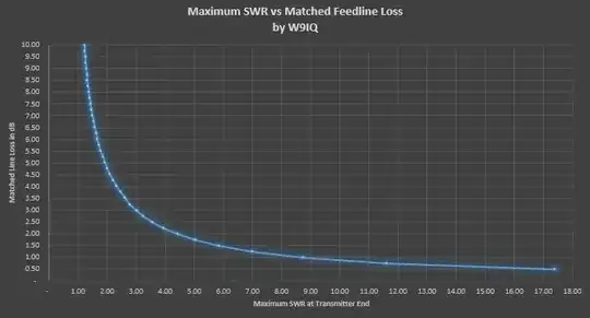

$$\text{SWR}_\text{max}=\frac {1+\sqrt{\text{Percent Loss}^2}} {1-\sqrt{\text{Percent Loss}^2}}=\frac {1+\text{Percent Loss}}{1-\text{Percent Loss}} \tag 3$$
If we now make a plot of formula 3, we get the following view of matched loss vs. maximum SWR:
Figure 3
Formula 3 can be converted to a version that directly uses dB matched loss:
$$\text{SWR}_\text{max}=\frac {1}{\tanh \left({\frac{L_{dB}}{8.686}}\right)} \tag 4$$
