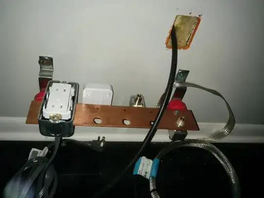

Here's my station ground almost completed as an example. This is where the feedlines enter the house: the desk is 15 feet away on the other side of the room. All the cables from the desk run to this bulkhead.
On the bulkhead are two gas tube surge arresters for feedlines (from Polyphaser), at electrical outlet with integrated MOV (Lutron), and a TVS diode protection device for the ethernet cable (Ubiquiti).
The braid will go to the ground rod just outside. That ground rod is connected with buried solid uninsulated 6 AWG wire to the electrical service entrance 40 feet away, with another rod every 10 feet along the way.
Not pictured is a larger 30 kA MOV in the main breaker panel on the other side of the house.
