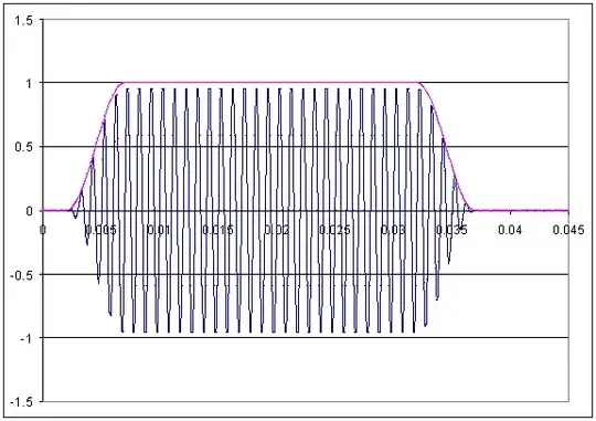

CW transmitters do not come up to full power instantaneously, and produce waveforms like this:
Note that as this is displayed in the time domain relative to the keying frequency, the actual carrier is not visible.
So even if the modulation itself (the key, acting as a switch) is a square wave, the resulting output is not truly square due to the physical constraints of the components of the transmitter.
This is true for both the rise and fall of the envelope.
Here is another example:
In this plot, relative to the carrier frequency, it is clearly seen that in a practical sense the transmitted wave envelope does indeed begin and end at the boundary conditions of zero.
Of course, philosophers have been known to argue that it never actually reaches zero - just gets closer and closer to it. Then the quantum physicists bring up the Planck limits, and so on, ad nauseaum.

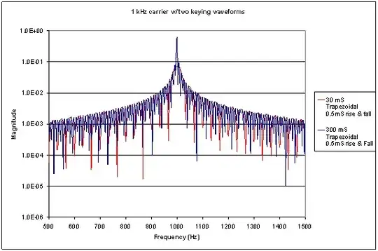

In the frequency domain it will look like this:
Note that this is a plot of a signal modulated by 1 KHz square-waves, which is why the bandwidth is spread so widely. At 1 KHz keying, the ratio of signal to modulation frequencies are getting to the point where it is producing sidebands. The amplitudes of the sidebands fall off in the normal way. This plot does not show the effects of input filtering.
