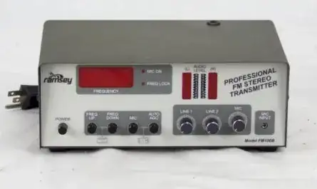

A typical Part 15 FM radio transmitter is the Ramsey FM100B.
Note that there is no limit to the number of transmitters that can be operated, so it is possible to cover an entire city block or more if you have enough transmitters.
(The Ramsey FM100B was also offered for overseas buyers as a 1 Watt transmitter through the addition of a secondary power amplifier board)

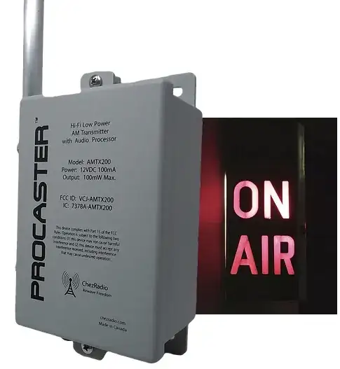

For longer distances, Part 15 AM is often a better choice because of the availability of radios like the Chezradio Procaster, which is FCC type-certified when operated with the integrated antenna.
Part 15 AM is limited to 100mW power output and a 10-foot antenna-to-ground length.
This opens many possibilities especially in terms of range. For instance, a Procaster on a rooftop with a 20-wire radial system (a counterpoise, or artificial ground) can often reach more than a half mile in radius.

The particular FM transmitter shown above has 2 RCA input jacks for each Line, and a 1/8" (3.5mm) jack for Mic Input. In other words, it has an internal mixer.

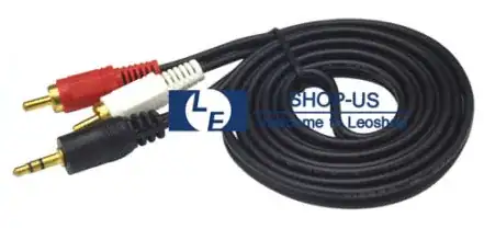

The only cable required to connect to a Line input from a PC is a generic one like this:
New 3.5mm 1/8" Stereo Male to 2 RCA Male AUX Audio Stereo Adapter Y Cable Cord

  • The Ramsey transmitter you linked is actually not legal to use in the USA, the power output is much too high (several orders of magnitude). In fact, the FCC issued a NAL against them (https://apps.fcc.gov/edocs_public/attachmatch/DA-06-136A1.pdf) – PhilippNagel Oct 18 '17 at 19:31
  • The link is to the Chezradio FCC Type-accepted AM transmitter with integrated antenna. The image of the FM transmitter is by way of example. It probably answers the OP. Note that there has never been an action against anyone using one, and Ramsey still sells them in kit form. That means that the operator of such a unit assumes full responsibility to comply with FCC rules and regulations, and in particular with United States Code of Federal Regulations, Title 47, Part 15 (47 CFR 15) – SDsolar Oct 19 '17 at 01:24
  • PhilippNagel, Ramsey offered two versions of that exact FM transmitter. One that is lower powered, then also a 1-Watt version (just the addition of an internal power amplifier board) that they wouldn't sell to USA customers. You can't tell the difference from looking at it on the outside. – SDsolar Apr 26 '18 at 01:41
