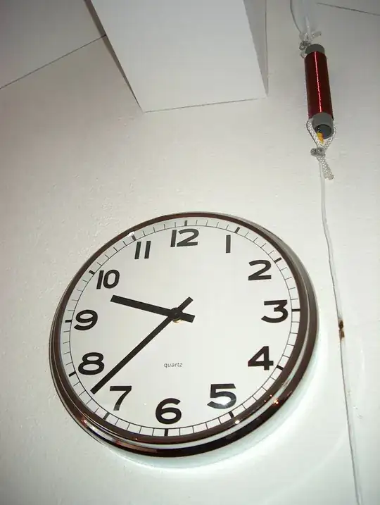

If the antenna is loaded with a coil, the impedance will be transformed up to an even higher value. This is how a Tesla coil works. The resulting corona effect might be quite dramatic as shown in the picture below (1kW on 80m in short W4JRW dual-band dipole @ HB9DWU).
1kW on 80m
