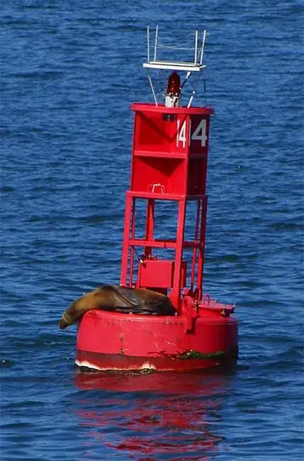

Corner Reflectors
Also, for example, if you have a wave hitting a 90° corner of reflective material (e.g. the side of ship and its deck, a sharp cliff and the sea beneath), you get nearly all of the transmitted energy back in the direction the wave came from. That's the same principle why bike reflectors have these pyramidal structures:
corner reflection
You'll see that being used for radio purposes, e.g. to make vessels more visible to ship radars by maximizing the amount of radio energy getting reflected back at the emitter. Can you spot the corner reflector in this seal relaxation pod buoy?
Buoy with corner reflector

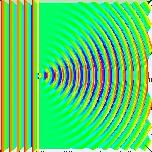

Diffraction
Then, we have effects like diffraction – the fact that when a wave hits some kind of obstacle with an edge, it extends behind that edge. Here's an example from the wikipedia page on Diffraction. The plane wave enters from left, and then hits the yellow obstacle with a small slit in the middle.
Diffraction
The very same happens at the tops of mountains – at the crest, the waves "break" and diffract behind, reaching valleys that definitely don't have a line of sight to the transmitter.
