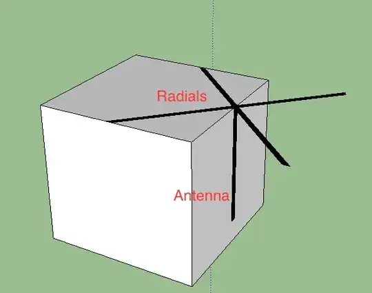

EDIT: Might the way of attachment shown in the picture be a solution? Possible solution?

  • Thanks for your answer. The trouble with mounting an antenna on the bottom of the payload is that it would make the payload tip over at landing, meaning the satellite tracker would no longer face the sky and loose its signal. You said that The styrofoam is rf transparent. That made me think, maybe you could mount the antenna like in the picture I added to the question right now (see above). Would that work? There may be some circuitry directly below the 2 radials which are on the top of the payload. – user5227744 May 02 '17 at 11:58
  • With the antenna made as suggested, it will likely fold over on inpact to the ground. Were you to install it the way you have on that picture you would stand a pretty good chance of completely detuning it because now the contents of the box are inside of the transmission plane as opposed to below it or in this case above it. You'll end up with three antennas per one for the SAT tracker, one for the GPS and one for the downward-pointing radio. Once the unit is on the ground you won't be getting updates for position but you won't need them either because you'll have the last update of position. – Rowan Hawkins May 02 '17 at 13:01
  • Your building something that is approximately a Cube. Unless the contents are perfectly centered inside of it, it's going to bounce around like a loaded dice when it hits the ground. This will not be a gentle parachute landing because there is no parachute. The other option is it will get stuck in a tree and you have to go find the landowner to find out if you can cut down the tree to get it. – Rowan Hawkins May 02 '17 at 13:27
