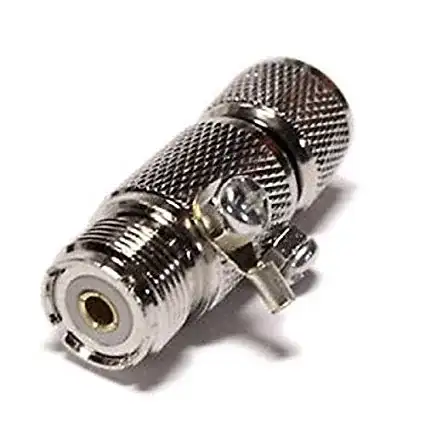

Here is what is advertised (and recommended by Elmers in my ham club) to connect your coax to a local ground. It is called a Lightning Arrester.
It has an internal spark gap that will only be jumped by a high voltage coming in from your antenna.
There is no direct connection that will have any effect on the antenna, as long as this on at the near end of the coax, and not right at the antenna.
Lightning Arrester
They are available from the usual sources.
I recommend grounding this the same place your radio chassis is grounded. That way this is nothing but a pass-through connector with an internal spark gap.
SDsolar

    That little screw terminal alone will provide effectively no lighting protection at all. By grounding this to a water spigot, etc, you are creating a low impedance path between two ground rods which will not be at the same potential when there's a nearby strike, a low impedance which goes through your equipment. This is a recipe for bad times. – Phil Frost - W8II Apr 02 '17 at 12:38
  • How could it go through the equipment when it will only jump the internal spark gap during a strike? – SDsolar Apr 02 '17 at 20:45
    It won't jump just the spark gap. Do you think that puny terminal lug and that teeny spark gap will really contain an entire lighting bolt? And what about the non-zero impedance of the connection to ground, and of the soil? Why would all the current go through that ground lug, especially when the wire attached to it is much smaller and thus higher impedance than the coax shield? How will this device help with the difference in potential between two ground rods: one at the electrical panel, another at the antenna? – Phil Frost - W8II Apr 03 '17 at 13:28
  • I agree about the shield, hence my comment that it should be grounded to the same place as the radio. (So, what two rods are you referring to?) Meanwhile, just think a minute about what you're saying. Do you REALLY expect your dipole to be your primary method of lightning protection? Next time you see a large rocket launch, notice the towers all around the rocket. They discharge the air to prevent strikes on the asset. Look up lightning rods - a la Ben Franklin. THAT's the best way to perform lightning protection. But the OP simply asked how to ground a dipole. So there you are. – SDsolar Apr 03 '17 at 18:16
  • Thanks for editing your answer. I think you should make clear that the place the radio chassis is grounded is almost certainly the electrical service ground. If one has the good fortune to have a feedline which runs past the service panel, that's an excellent place for grounding. If not, a new common ground point must be established for the station. – Phil Frost - W8II Apr 04 '17 at 12:22
  • Also, do you have a modern reference demonstrating that lightning rods discharge the air to prevent strikes? This was a hypothesis put forth by Franklin 264 years ago. The "lightning rods" at SLC-40 are not pointed as Franklin would have done: in fact they aren't even rods but rather a cage of wires. His lightning rods were nevertheless effective in diverting lightning to prevent fire. Constructing such an expensive system to divert lightning away from a $25 dipole is unnecessary. – Phil Frost - W8II Apr 04 '17 at 12:48
  • The NFPA at least does not believe there is sufficient literature to support dissipation arrays: http://www.lightningsafetyalliance.com/documents/das_cts.pdf – Phil Frost - W8II Apr 04 '17 at 12:57
