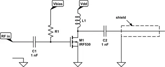

Neglecting biasing, impedance matching, and other details, you might drive it like this:

An issue is a dipole is a balanced antenna, so to feed it properly with coax you need a balun at the feedpoint.

  • Say my coax impedance and dipole antenna impedance is close enough so that I don't need any matching. In that case say I decide to drive my antenna through the first circuit in your answer. But here I again face the ground issue as the coax shield is grounded. As I don't have transformers at my disposal. My plan is to use the first circuit. – user3001408 Feb 15 '17 at 06:13
  • @user3001408 It will work, for sure. The main issue is to make sure the PCB layout keeps the ground currents quiet for the receiver. With the antenna isolated with a transformer it's much easier since the grounds can be isolated. – Phil Frost - W8II Feb 15 '17 at 17:22
