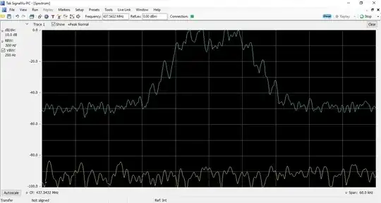

Unfortunately neither my location nor my messages showed up on ariss.net . I captured the signal by using a Tektronix PC-based spectrum analyser and got the following
Spectrum
Each box is 6khz wide. This means that at -10dB, the bandwidth is around 12000Hz which is more than I expected. So here are my two questions
  1. Question 1:
    I have verified that the 9600 bps mode is switched off on the ICOM. How come the signal is that wide?
  2. Question 2
Is the baud rate of my AFSK 1200 audio tones dictated by ICOM or by the TNC? If it is dictated by the TNC, then which command should I use to set it to 1200?

    Despite usually be labelled "data", the interface between the TNC and the radio is just analog audio. Any baud rate settings on the radio are possibly for a built-in TNC. The command to change the baud rate on the KAM XL should be in its manual, but they've made it impossible to search within that document so you'll need to read around. – Phil Frost - W8II Feb 09 '17 at 19:57
    The width is fine, remember you're doing AFSK, so the width of the signal depends primarily on the FM deviation. Isn't the ISS digi currently dead? That would explain lack of reception. – hobbs - KC2G Apr 16 '18 at 20:57
