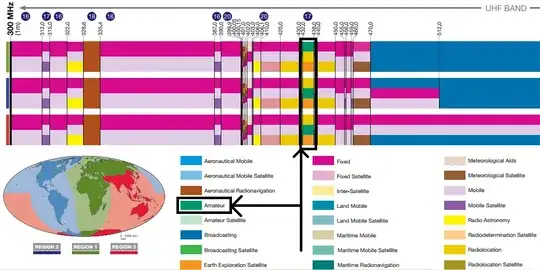

From this poster, http://info.tek.com/AM-RSA306-Spectrum-Poster.html, enter image description here
it indicates that a band around 433 MHz is globally-accepted for use as an amateur band.
Can this same band be used for industrial-scientific-medical (ISM) purposes?
