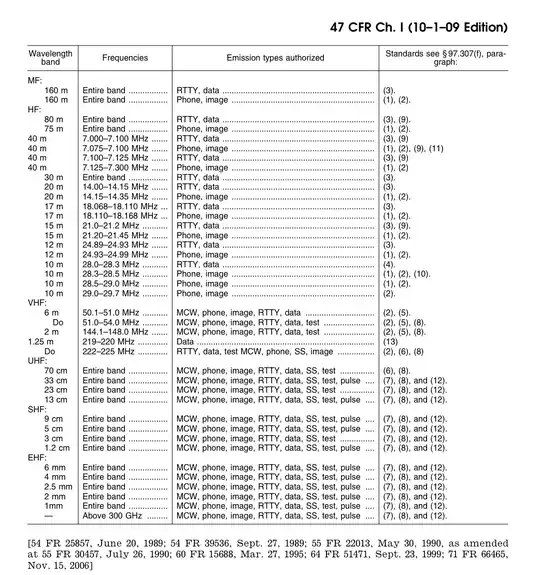

This is indeed in the FCC regulations. In Part 97, section 305 regarding "Authorized Emission Types" there is the following chart which lists two relevant subbands, see in the VHF group the 6m row and the Do ditto right below it:
FCC table showing authorized emission types by frequency range
Tracing our way outwards from there, we find:

Let's zero in on the difference between 50.1–51.0 MHz range vs. the 51.0-54.0 MHz range.* The first frequencies allow emissions of type "MCW, phone, image, RTTY, data" whereas the second allow all that and "…, test". This must be exactly what the ARRL chart is referring to. So yes, 51 MHz is the correct boundary for where "test" emissions may occur.

But to expand on that a bit, the table above also has a "standards" column which lists only (2), (5) for the 50.1–51 MHz subband, but (2), (5), (8) for the 51.0–54.0 MHz portion [see updates below — this column is a red herring re. "test" emissions]. The definitions of these standards are given in § 97.301(f) within numbered paragraphs.

UPDATE: thanks to WA9ZZZ's answer I know think it's clear that the paragraph (8) standard has nothing to do with the "test" emissions also allowed starting at 51 MHz. (Case in point: note how the 23 cm and 13 cm band rows in the table have the same three Standards listed in that column, but one has "pulse" and the other doesn't in the "Emission types" column! Those columns aren't tied as closely as I originally assumed.)

    I think you're right. In my answer I got sucked into the numbering in the right-hand "standards" column of the chart (the (2), (5) vs. (2), (5), (8)) and assumed it was simply the actual fine print of the "emission types authorized" column. But that can't be the case! As a clearer counterexample compare the 23 cm vs. 13 cm bands — both have the same (7), (8), and (12) in the standards column, but yet in one band "pulse" emissions are authorized and in the other they're not listed. – natevw - AF7TB Oct 11 '22 at 19:14
  • I didn't try trace this all the way through the years; it seems the section numbering is constantly changing. But I did have a 1984 edition of Part 97 handy on the shelf, and its older version of a roughly equivalent table clearly shows that A0,F0 get added only in 51.0–54.0 range and up. Those designators answer here also ± lines up with the definition of "Test" emissions in the current regulations, presuming that a 0 — None nature of modulating signal goes hand-in-hand with a N — None information type. – natevw - AF7TB Oct 11 '22 at 19:22
  • I think your comment is right. The "data" emission type has a certain number of designators. Paragraph (8) allows additional designators at higher frequencies. It has nothing to do with "test" emissions except for the frequencies where it is allowed. – WA9ZZZ Oct 11 '22 at 22:37
