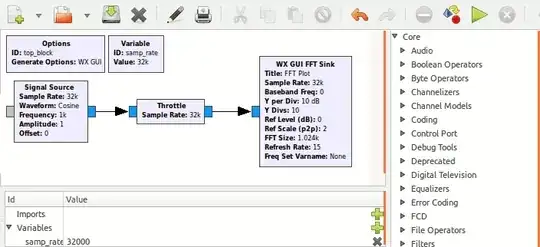

GNU Radio has a Signal Source Block which considers a set of variables to produce an output, namely sample rate, frequency and amplitude.
In signal processing, we define a basic waveform by its frequency, number of samples within the period and its amplitude. This holds true for waveforms such as Sine, Cosine, etc.
In GNU Radio, the sample rate doesn't really mean sample rate. And the frequency does not mean the frequency of the signal. This is really confusing to understand. I insert a screenshot of my build below
GNU Radio companion showing the flow graph: Signal Source ->  Throttle -> WX GUI FFT Sink
My question is, if sample rate is defined in the signal generator box, we do not need another throttle box. Because the Signal Generation box must know that it shouldn't generate more than the amount of samples it's advised in the configuration. However, if we remove the Throttle Box, the CPU goes to 100% and PC gets Stuck.
I would like a bit of clarification of on this issue. I'm sure I am wrong. People who made GNU radio must have been very smart people who have had a specific reason for doing this. I would like to know that reason.

    Just a comment: Don't use WX GUI FFT Sink, but the QT GUI Frequency Sink. GNU Radio is dropping WX in the next release – simply because the Qt sinks are faster, smoother, work on more machines, and most importantly, we still know how to maintain them :) – Marcus Müller Dec 17 '16 at 10:19

Minimal flow graph
Thus, in your flow graph (without the Throttle), GNU Radio simply asks the Signal Source to produce as many samples as there's free space in its output buffer. The Signal Source happily obliges and fills that buffer with a cosine of 32 samples per period – and then tells GNU Radio it's done doing that and it in fact did produce so-and-so-many samples. GNU Radio takes that info and tells the GUI Sink "Hey, there's so-and-so-many samples in your input buffer, get to work!", and the sink just goes ahead and processes these as fast as it can. It signals GNU Radio when it's done how many of the samples that it was offered it actually consumed – and GNU Radio then knows that this portion of the buffer is free again
Since that happens as fast as possible, this flow graph tends to eat up two processor cores completely, because GNU Radio is clever and maximizes throughput by distributing different blocks to different concurrent threads – that way, the source can already be producing the next chunk of samples, while the sink is still consuming the first one, leading to a scenario where there's practically no waiting for new input – there's always something to be done. Again, in a scenario where you want to process millions of samples per second coming from a hardware source, or going to a hardware sink, this is very desirable – simply because the throughput would be hard to achieve if everyone would be waiting most of the time instead of everyone trying to work as fast as possible on their own CPU core.
Throttle does exactly nothing to the samples. It's really just a "copy the bytes from the input to the output buffer" operation. But it just lets that copy action sleep() for a while to achieve an average throughput of the sample rate you configured. It's thus really just a tool for simulation at medium rates. Never use Throttle in conjunction with a hardware block – no two clocks are exactly the same, and if your hardware samples but a little faster than your Throttle throttles (because that's done with a rather inaccurate CPU clock time), you'll end up damaging your signal somewhere, either because your hardware sink didn't get things fast enough and had nothing to convert to analog when it was time, or because your hardware source completely runs out of buffers to put received samples to, and has to drop them.
