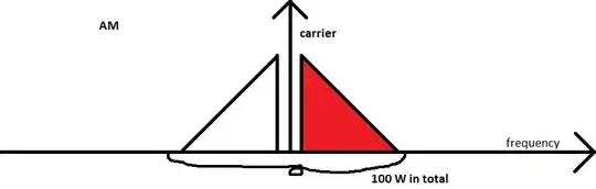

So let's first take a (simplified) look at AM: AM spectrum We have a carrier and two sidebands. One sideband, the part in red on the picture, actually carries useful information. The carrier is not needed, if we can precisely tune to the frequency, and the other sideband is just a copy of the red sideband. What is important is that when we sum the power over the frequency, we'd get the full power that the transmitter can provide. So for 3 kHz of audio bandwidth, we have 6 kHz of RF bandwidth and 100 watts unevenly spread out over that range.
Now when we're looking into SSB, first we need to better define AM. The usual colloquial AM is actually amplitude modulation, double sideband with carrier.

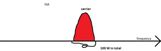

In case of FM, we'll get a symmetrical spectrum again: FM spectrum
In this case, we'll usually get wider spectrum than usual AM which will be from around 10 kHz (European CB) to 25 kHz (older "wideband" FM transceivers, still used for amateur radio in some areas). The usual formula is BW=2*(Baudio+MaxDeviation). So for our 3 kHz of audio and deviation of 2 kHz, we'll need 2*(3+2)=10 kHz of bandwidth. It should also be noted that until recently, it was difficult to get low deviation values.
So again, we'll be spreading out our 100 W over wider bandwidth. On the other hand, FM does not suffer from the same issues as the AM does, so we basically get better audio quality from FM than we get from AM. The downside is that FM requires "large" bandwidth, resulting in lower power spectral density at the receiver. For line-of-sight communications, usually, the received power is more-or-less OK, so we can afford to waste some bandwidth for higher audio quality.
