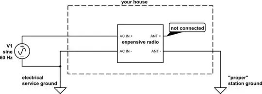

You question seems to boil down to this: "Do I need to be concerned about lightning protection, even though my antenna isn't very high relative to its surroundings?"
The answer is yes. In fact you need to worry about lighting protection even if you have no antenna at all.
Say you have this:
schematic
simulate this circuit – Schematic created using CircuitLab
You have your radios and whatever connected to a great big ground rod near the station. Maybe you attach the ground to the chassis, or maybe it's part of the ground for your antennas. Maybe you even make all the connections with heavy copper strap. Maybe you even have a mesh mat under the floor and the desk. This station is really grounded.
And there isn't even an antenna. A lightning strike directly on your station is quite unlikely.
Safe, right? No. We have failed to model the finite conductivity of the soil between the two ground rods. The situation is more like this:

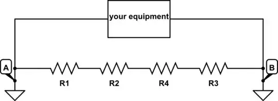

schematic
Soil conducts electricity, but not very well, represented by the resistors between the two grounds. Now when lightning strikes nearby, maybe on the ground, maybe a tree, or maybe it hits the power lines, all that charge transferred by the strike needs to go somewhere.
At the strike point, and at the instant the strike occurred, there's an excess of electric charge that was put there by the strike. Like charges repel, and so all this electric charge flies away from the strike point, until it's more or less evenly distributed over the surface of the Earth.
Where does it flow? Like all current, wherever it can. The lower the impedance of some path, the more the current will flow there. The soil is pretty resistive, and copper wires that run through your equipment is not. So you are providing the strike current a shortcut through the relatively poor soil conductor which goes through your equipment, probably resulting in damage.
Lightning arrestors won't help you at all with this particular problem. They are essentially spark gaps. Consider, the strike current is driven by a force strong enough to create an arc between the ground and the clouds. A little piece of metal isn't going to stop the current that needs to get from point A to point B.
This is why you must consider lightning protection, no matter what your antenna installation, or indeed, even if you have no antenna at all. You must make sure there is no path between two points in the ground which flows through your equipment. "Properly" grounding your antenna is likely to do exactly this.
See How can I protect equipment against a lightning strike? for a more detailed explanation of how to ground your station in such a way that lightning damage is unlikely.

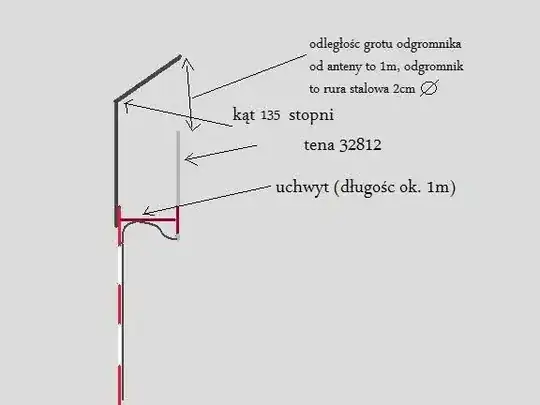

Polish professional antennas installation (police, firemen), antenna type 32812 similar in sizes to x200 are mounted like this (sorry, cant find with english description) odgromnik - arrestor odległość - distance długość - length
EDIT: I do not negate rest of discussion. Problem should be resolved in good, complex way - or not resolved all, i.e. problem of loop ground

  • Hello Jacek and welcome to ham.stackexchange.com! Your picture is interesting, I don't think I've seen an antenna with a lightning rod attached to it. That must discourage a direct lightning hit. I wonder how the lightning rod changes the pattern or the impedance of the antenna? – rclocher3 May 24 '16 at 15:36
  • Agree, HAM way of thinking is full of care about every dB of signal. Maybe professional way is different? No-one from professional seller-installer have problem "oh no! 1.5dB lower!!!" Police, firemans units have limited service area – Jacek Cz May 24 '16 at 15:44
  • This is photo version, from firm selling in professional market http://www.dipol.com.pl/images/a074.jpg – Jacek Cz May 24 '16 at 15:49
  • I meet rule "distance > 0.5 lambda from metal mast is sufficient, 1 lambda happy", for pro freq 170MHz lamba (wave length) is .1.7m. Non-resonance distance probably is better??? – Jacek Cz May 24 '16 at 15:53
