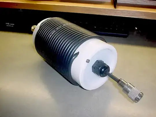

I suppose the air-wound "ugly balun" as demonstrated at http://www.hamuniverse.com/balun.html also fits in this same category, unless using coax in place of the bifilar winding somehow changes things?
Coax wrapped repeatedly around a large-diameter PVC tube

  3. Third is a classic "Ugly balun" or air core solenoid balun. They CAN work, however because capacitance in the coil is quite high (without looking, I believe RG-8X is ~5pF/ft), they are self-resonant tank circuits. This means that they can present quite useful impedance on a couple of bands at most, but otherwise may be all but invisible on other bands. They can be strung together along the coax, but you end up using a lot of extra coax that equates to more loss, and it's far more expensive than just buying a proper toroid for $5.
