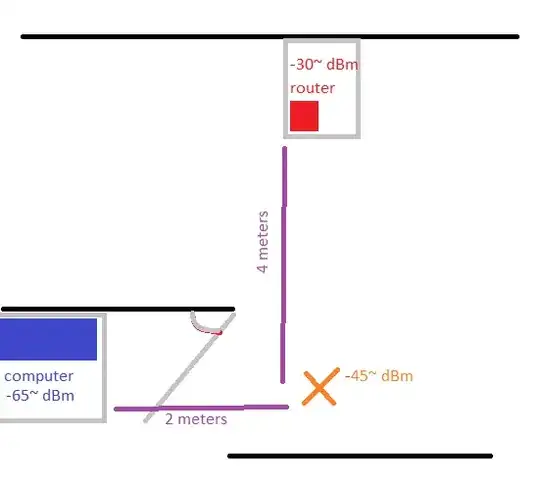

There's a concrete wall between my computer and my router (Linksys E900) which affects my WIFI reception pretty harshly, computer receives signal is at -65 dBm, at this rate i get around 5%~8% packet loss. Without the concrete wall blocking the signal i get around -30 dBm to -45 dBm, which results in only about 1% packet loss. (Tested with desktop and laptop).
http://i.imgur.com/AQhodaQ.png
The idea
There's a door in my room, perhaps if I could make my own passive repeater, bending the WIFI's radio wave's path to turn a corner (and go through the door instead of the concrete wall), would my WIFI reception increase significantly?
If this is a good idea, how do I go about making it?
Where do I learn the math on how big the repeater needs to be and how to position it? What materials do I need for this?

While passive repeaters do exist, I don't think building one for your apartment would be feasible or useful. As you can see in that article, they are usually quite large.
Moreover, a signal of -65 dBm is not excellent, but it's at least good and will work reliably, given no additional problems. So this doesn't really explain your situation.
In many WiFi receivers, the RSSI, from which that signal level is calculated, is actually a measure of the receiver's automatic gain control (AGC) level. The AGC is responsible for adjusting the gain of the RF amplifier such that the input to the demodulator (the part that decodes the WiFi signal) is at an appropriate level. It's like adjusting the volume on your radio so it's not so loud that it hurts your ears, but also so it's loud enough you can clearly hear it.
However, the AGC responds to noise as well as signal. It can't know the difference, and in fact no receiver can. Were it possible to separate noise from signal then noise wouldn't be a problem because it could just be discarded.
So the more likely explanation is that your packet loss is due to noise. Professional WiFi radios provide metrics on things like CRC errors which quantify noise more precisely, and spectrum analyzers can measure noise directly. Some professional-level WiFi radios even have a crude spectrum analyzer built in. But consumer WiFi radios are unlikely to expose these features, so we just have to guess.
Reducing the noise is the first thing you should try. You might find another channel has less noise. Try using the 5 GHz band if you can: it has more channels, and generally less noise.
If you've done all you can to reduce noise and you still have problems, you can increase the signal. If you can't move the AP closer, then you could try a directional antenna. If that won't work, then a WiFi "range extender" is an active repeater that is pretty cheap. Using such a repeater does mean you will be making roughly twice as much noise for your neighbors, but maybe that doesn't bother you.
