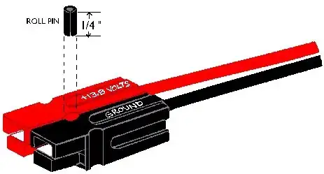

Firstly, there's a hole for a locking pin in the connectors. The pin prevents the connectors from sliding apart. If there's a pin in there, you'll need to push it out with a punch.
roll pin
If there isn't a pin, it's possible the connector was assembled with cyanoacrylate glue. Since the roll pin can sometimes fall out, Anderson recommends glue in applications where this would be a problem. In this case you may not be able to get the connectors apart without damage.
With the roll pin removed, the connectors slide apart. Each side of the connector will have either a groove or a tongue. If one side has a groove, the opposite side will always have a tongue, so you should be able to determine the necessary sliding direction by looking at the connector. An image helps:

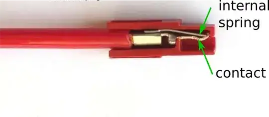

If that's not possible, then you may be able to get the contacts out of the housing. There's a tool for doing this. If you don't have or don't care to purchase the tool, then you may be able to improvise something similar with a bent piece of metal.
The contacts are held in place by an internal spring.
You need to get something around and behind the contact to push up the spring. The spring is what retains the contact: by lifting the spring the contact will be free to slide out.
Take care to avoid bending the contact when doing this: if the contact is bent it may no longer make solid contact with the mating connector. Where possible I'd advise discarding the old contacts and attaching new contacts.

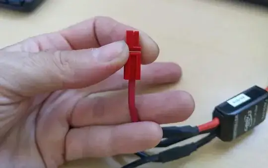

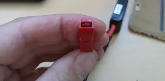

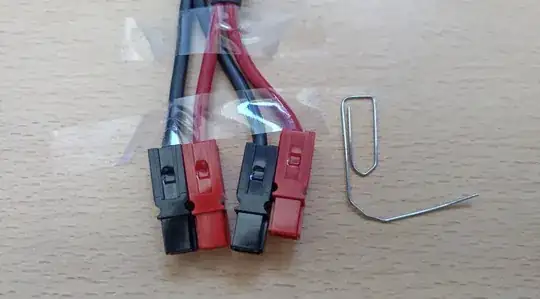

  1. Prepare connectors - slide them apart, if not already, and get a paperclip, or something similarly strong and thin prepare - break apart connectors, unbend paperclip
  2. Look into Anderson connector, and identify inner parts; use the image from Phil Frost's answer for reference identify inner parts - contact, and a spring behind it
  3. Hold wire with fourth and fifth fingers, and hold connector with thumb & index finger hold wire with 4 & 5, and hold connector with 1 & 2
  4. Thank or ask God for help, and proceed - push unbent part of the paperclip into the spring, which is only slightly visible behind the contact; after you successfully push spring away from contact, hold / push wire down with fourth and fifth fingers, and pull plastic connector housing up (with thumb and index finger); this might take some try and error
  5. After you manage to pull the wire a few millimeters (about 1/10th of an inch) out from housing, so the spring is no longer holding the contact, hold wire with one hand, and carefully pull the plastic housing with the other hand
  6. The job is done!
push spring up, hold wire down, and pull plastic housing up job done
