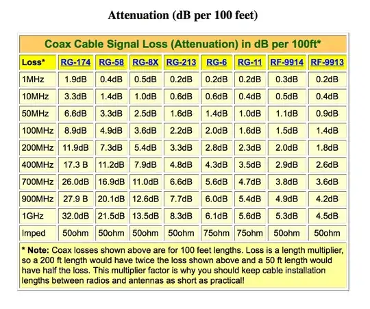

Unless you are operating VHF and above, abide by the rule of never cutting your coax cable unless you absolutely must for some reason. What you need today may be 20 feet but a new antenna you might put up next may need 40 feet. If you are active in ham radio, especially with HF, you will probably have dozens of antennas over the life of your coax.
Here is a coax attenuation chart showing loss per frequency per cable type. There are dozens of such charts to be found on the Internet via google.
