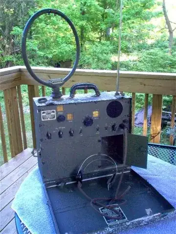

If a full-sized VHF antenna is too big, then look at how people do direction finding on HF. A longer wavelengh means bigger antennas, so HF direction finders have been dealing with the "too big" problem for a long time.
The canonical HF direction finding antenna is a small loop. This antenna is vertically polarized and gives two nulls when the plane of the loop is perpendicular to the source. The nulls are pretty sharp and deep. So instead of finding the direction where the signal strength is strongest, the operator finds the direction where the strength is weakest.
Here's a US Navy radio direction finder. Of course if you scale this down to VHF sizes and build it with modern electronics it will be much smaller.
See the source for many more examples.
Of course this gives two directions. One way to deal with this taking measurements from two locations and triangulating. In one direction the lines implied by the two measurements intersect, and that's where the source is. In the other direction the lines don't intersect so it doesn't matter.
Another solution to the two-direction problem is to add an omnidirectional antenna, making a phased array. The directionality of this array isn't great, but it's enough to figure out in which of the two directions is the source. You can see such a thing as the vertical rod on the right of the direction finder above.
