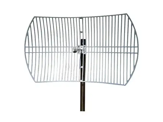

My advice for research directions would be to look for let's say parabolic antenna for your band of interest:
TL-ANT5830B from TP-LINK
plus an access point. For access point, my advice would be to look to one of the third-party GNU/Linux distributions for routers and similar equipment. Fro example OpenWRT. Then look for the devices on their supported list and find one you like. OpenWRT and the like will give you more than enough options to fine-tune the WiFi settings you have and will also be able to improve security in the long run. since they actually receive updates, unlike stock firmwares for cheap units. The down-side of this approach is that if you want modern features such as antenna diversity and spatial multiplexing, you'll need two to four antennas per AP, which can get costly. A ballpark price for an antenna could be around USD 50 plus maybe USD 50 to USD 100 for an AP, plus low-loss coaxial cabling and installation costs. Keep in mind that the traditional distance between antennas i simpler diversity or multiplexing setups should be half of wavelength or odd multiple of it.

Next, there's the part where you should calculate how much gain you actually need. You'll often be able to find tables with minimum signal strength needed for various modulation types from WiFi equipment manufacturers in tables such as one on this page. Speed rates
You should use that information to give yourself a base-line of how much power you need at the receiver.
Next step is to take the antenna gain in dBi and subtract the cable loss in dB from it and then repeat the calculation for the receiver. This will give you a sort of let me call it "effective" antenna gain, that you can later on use for different types of calculators. Cable loss is calculated by getting the manufacturer's specification that will list it usually in loss per meter, per foot or per 100 feet/30 meters or per 100 meters and then add the loss of the connectors, if you want to be really picky.
After that, you can go to a Friis calculator such as this one and use it to calculate the path loss for your distance and put the info from your equipment such as the gains you calculated previously and the transmitter power. The output will be received power, which needs to be higher than the minimum power needed for the speed you want to use, plus some more decibels for extra safety margin, just in case of bad weather or similar. If the numbers don't fit, you can try to do trade-offs. You could switch to a higher-gain antenna, but that would be more expensive, you could move to a lower-loss cable, you could try to use a higher-power transmitter, but that can very easily be illegal if you break the local rules and so on.
Finally, there's the part where you should decide which band you want to use. If you want to use regular WiFi bands (meaning cheap equipment), you should do a "site survey" of some sort. Basically, you need to see which channels are free in the area. In general, 2.4 GHz is the band with larger antennas, cheaper APs and is more crowded. The path loss is lower in this band.
In 5 GHz band, the antennas are smaller, there are more channels and usually much less users (this is VERY important for a good-working link). Also the newest IEEE 802.11 ac standard only works in this band. You'll also have more space for use of wider bandwidth transmissions. The path loss here is usually higher, so you can expect your signal to be around 6-7 dB weaker than in 2.4 GHz band. Equipment is also somewhat more expensive.
With latest AC equipment, you can expect a bit less than 1 gigabit per second speeds with a good WiFi installation, but that can somewhat deteriorate with weather.
Finally, let me remind you to check local regulations on WiFi equipment. In some cases, you might have restrictions on antenna types, antenna gains, EIRP, outdoor installations, so that even though WiFi is in general considered license-free, the your specific application might need registration or license or might be (in the worst case) simply illegal.
