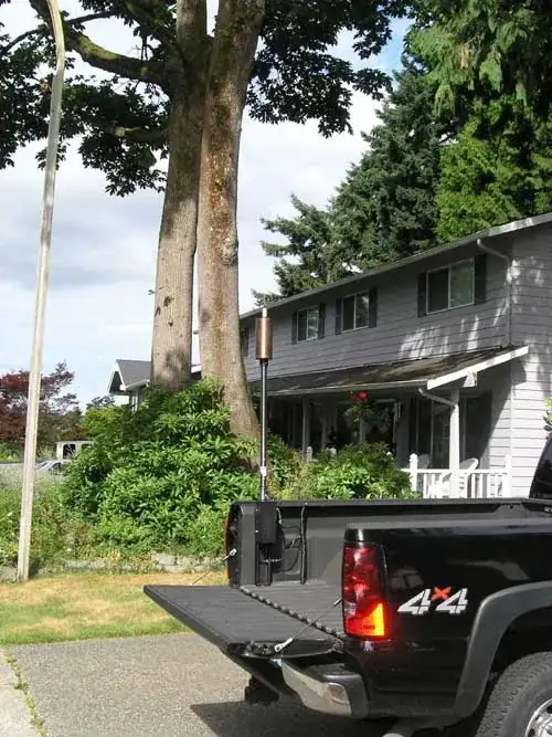

In my answer to the question I will augment the merged previous answers. I do not use a CB antenna but I do operate HF 3.5 thru 30 MHz ham bands using a Hi-Q 4/80 Screwdriver antenna mounted on the rear of my pickup truck as shown in the image below.
Although it is hard to see, above the center loaded coil is the top part of the antenna that extends about 3 feet or so above the coil. The top of the antenna is 11 feet, 4 inches from ground level.
Now, the best performance of this antenna is when operating on the 10-meter band which is similar to the CB band; although, the antenna mentioned by the OP seems to be a major compromise as a CB antenna (and, as Phil Frost says, all mobile antennas are a compromise).
For the best performance I have, I have bonded using copper strap conductors in about six spots under the truck -- bonding frame to metal cab and panel parts. Result -- significantly reduces the noise generated by the truck itself (ignition, computers, alternator, etc.). And, I assume that it has improved my ground plane but I have no actual experimental proof of that as I failed to do a before and after test as I did with the RFI problems of a mobile rig.
But, the ground plane itself of the truck is a significant part of the efficiency of the antenna. How do I know. I know because the signal strength (as measured by S-meter) and by cooperating hams during a QSO, is much better for the direction off the front of the Truck rather than the rear and even the sides. How much better? About a half S-unit better. In fact, If I am in a QSO while driving and the other station is off the front of the truck and I make a right hand turn then that signal drops appreciatively. Indeed, I have lost signals entirely merely by the direction I travel -- it is like rotating a Yagi beam antenna.
Mounting dead center of the vehicle is probably the best as mentioned earlier but that is very impractical for many antennas, especially those trying to cover HF frequencies. Mounting below metal though is also very bad such as mounting in the bed of my pickup truck. Having a position high and clear from as much metal as practical that is below the antenna is best which justified the position I used on my truck.
Performance?
I have made QSOs to the Falkland Islands, Indonesia, and other far off DX locations from my truck using this antenna and my Icom IC-706 MkIIg 100-watt rig. Also, I have contacted Cuba (from Washington State) via mobile CW on three different occasions from my truck. It works well for North American contacts too. Most of my operating though and all of the above examples were on 20 meters.
