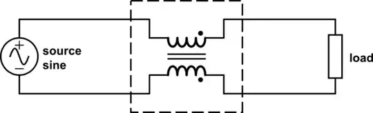

This is a common-mode choke:
schematic
simulate this circuit – Schematic created using CircuitLab
Common-mode current sees a high impedance, and is thus "choked". (Of course there's nothing drawn in this schematic which would introduce such a current, but the real world is not so simple.)
If you put a common-mode choke in a box with a coax connector at one end and screw terminals or some other balanced connector at the other end, you've made one kind of balun. It's 1:1 (because it performs no impedance transformation) and a current balun (because with high choking impedance, common-mode current approaches zero). And while theoretically there may be other possible designs for a 1:1 current balun, in practice "1:1 current balun" means "a common-mode choke with balanced and unbalanced connectors on it".

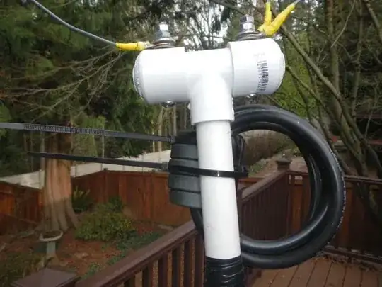

The image below is of one of my custom made choke baluns. This is an older one that used only five toroids.

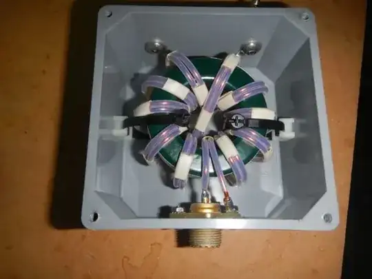

The following image shows one of my current baluns, a 1:1 5 KW balun.
