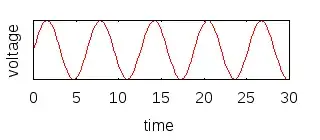

It looks like you are confused about what these graphs represent. Here's the diagram you used in the question:
Probably, this diagram is intended to be interpreted with the horizontal axis being time, and the vertical axis representing voltage or current.
Using that same representation, then SSB looks like this:

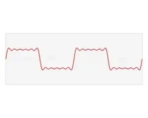

To illustrate, we can look at a square wave in the time domain ($f$), and see how it can be represented in the frequency domain ($\hat f$):
"Fourier transform time and frequency domains (small)" by Lucas V. Barbosa - Own work. Licensed under Public Domain via Wikimedia Commons.
We don't usually use square waves in radio communications because they have power spread over a wide range of frequencies. A square wave at 1 MHz also has energy at all the odd harmonics, 3 MHz, 5 MHz, 7 MHz, and so on. This would cause a lot of interference, since each station is typically allocated just a small channel in which to transmit. Broadcast FM, for example, is allocated a channel 200 kHz wide, and all their transmitted power has to fit in that. For example, from 89.7 MHz to 89.9 MHz.

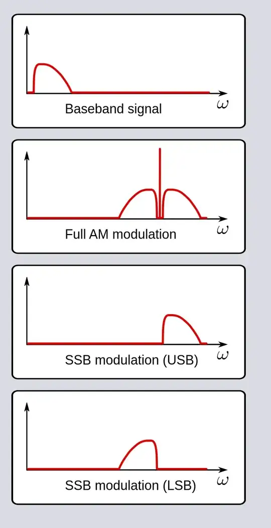

Bottom line, this chart from Wikipedia shows how the various modes work.

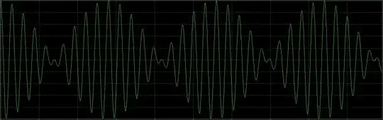

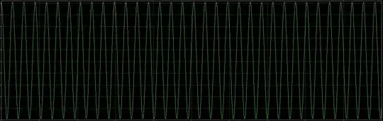

The picture below shows the oscilloscope image of a "carrier wave." The "carrier" sets the RF transmission frequency.
The picture below shows the oscilloscope image of an SSB signal modulated with two audio tones. This is a common test signal.
The original image you showed is the "envelope" of the modulation only; the "carrier" wave is not included. Note how the shape of your image is the same as the shape of the peaks and valleys in the second picture above.
