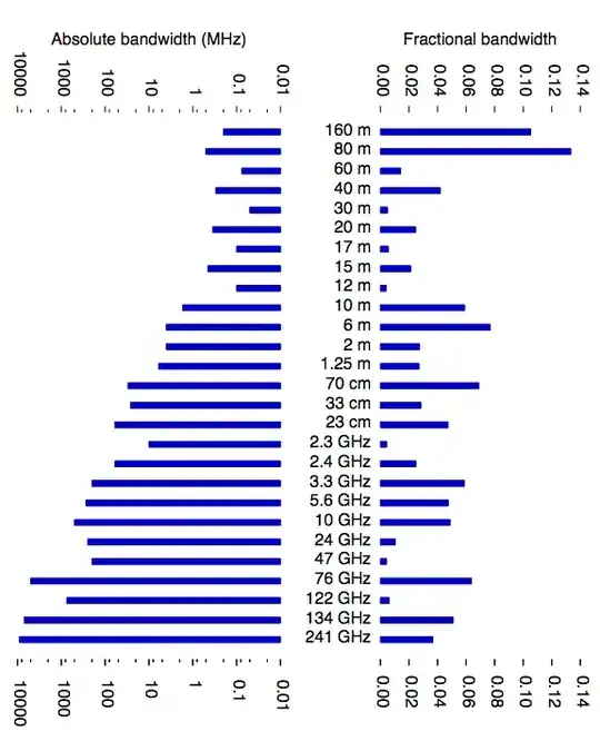

The usual figure used in this context is, apparently, fractional bandwidth, defined as the bandwidth divided by the center frequency, and therefore having a range of 0 to 2.
$$ \text{fractional bandwidth} \,=\, \frac{f_{\text{max}} - f_{\text{min}}}{f_{\text{center}}} \,=\, 2\frac{f_{\text{max}} - f_{\text{min}}}{f_{\text{max}} + f_{\text{min}}} $$
Given that definition, and using the United States band edges, here are the fractional (and absolute) bandwidths of all amateur bands:
This chart was generated using a gnuplot program which can be found in the source of this answer.

Here is a chart I made. Hope you find it useful. The numbers are approximate and it depends on your exact method of calculation. I use percentages because that information is easier to find or calculate. This chart is the average percentage using the center frequency (I also have numbers related to each band edge). A lot of people quote a "good" or "well designed" or "average" antenna as having about 10% bandwidth, but it varies a LOT with the exact antenna type in use. The "notoriously wide" bands are 160M, 80M, 10M (despite the smaller numbers), and I would add 6M and 70Cm.
 160M 10.55%
  80M 13.39%
  60M  1.36%
  40M  4.2%
  30M   .49%
  20M  2.47%
  17M   .55%
  15M  2.12%
  12M   .4%
  10M  5.9%
   6M  7.7%
   2M  2.74%
1.75M  2.7%
 70Cm  6.9%
 33Cm  2.84%
 23Cm  4.73%
