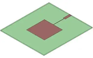

The second use is a quarter wave matching transformer. enter image description here
Using the formula we see that we can match Zin to Zload by a line with a suitable Z0. This has applications when we want to match a fixed load impedance, e.g. the input impedance of an antenna, to a fixed feeder impedance, say that of a transmission line, by inserting into the line a quarter wavelength of a different transmission line with a specially chosen characteristic impedance. That is, by having a mismatch at both ends, you choose a line impedance so that the two end impedances are the ones in your circuit. This is difficult with coax because there are only a few fixed values of Z0 to choose from. It can be more easily be applied to parallel lines, because their impedance can be changed by altering the diameter and spacing, and in microwave applications where the line is in the copper of a double sided printed circuit. For example, in the figure, a short 50 Ohm microstrip transmission line is matched to a square patch antenna (impedance typically 200 Ohms or more) via the thinner 1/4 wavelength microstrip line with a Z0 chosen to make the match.
(images courtesy of Wikipedia)
