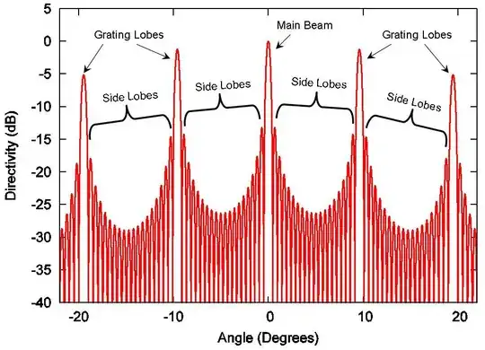

Effectively, the transmitter's antenna pattern has been modified to have a large number of narrow lobes. These are called "grating lobes" in the context of phased arrays:
Typical antenna pattern with grating lobes "Typical antenna pattern with grating lobes" by Mr. PIM at the English language Wikipedia. Licensed under CC BY-SA 3.0 via Wikimedia Commons
Notice how between the 5 large peaks, there are very many smaller peaks. Depending on the multipath geometry, there might be very many such peaks, and the receiver might not need to move very far from being in one of the peaks to one of the nulls.
And this is what most amateurs mean when they talk about "multipath" on FM. It's especially noticeable when operating from a moving vehicle where the mobile station might go through many of these peaks per second. When conditions conspire to make the nulls very deep, and the mobile station is at the edge of the repeater's coverage, the station can alternate between hitting the repeater and not. The resulting sound is sometimes called "picket-fencing", because it sounds like a station is moving past a picket fence where the individual pickets intermittently occlude the station.

  • If I understand well (my English skills are limited), you use phased arrays and "grating lobes" just as an analogy of the effect of multipath, as we usually have GP antennas that do not have side lobes? – Pedja YT9TP Jun 01 '17 at 09:48
  • @PedjaYT9TP Yes, sounds like you are understanding correctly. A single ground plane antenna receiving a signal through multiple paths is equivalent to two ground plane antennas receiving the same signal. It doesn't matter if you get two signals adding together because there are two paths, or two antennas. Sometimes they will interfere constructively, other times destructively. – Phil Frost - W8II Jun 01 '17 at 11:48
