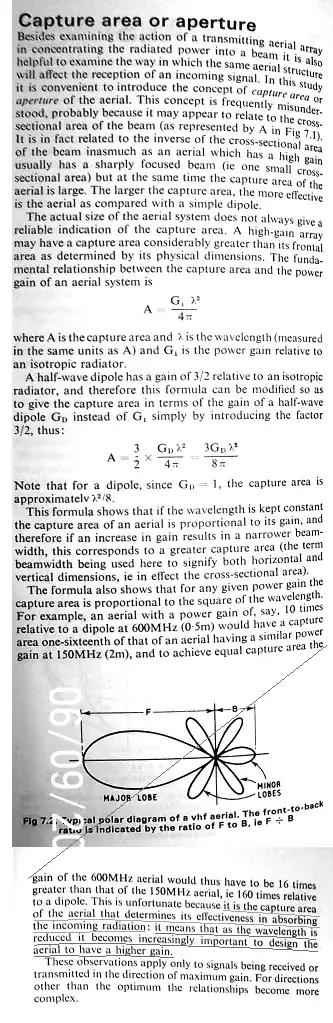

I'd like to offer a parallel and simplified explanation to W8II's correct answer above, for the mathematically-challenged VHF+ enthusiasts among us. :-)
As was mentioned in recent threads here, effective aperture is a measure of the power captured by an antenna. Effective aperture can be expressed as a function of the antenna gain and the wavelength.
Now, how does this affect real-world communications on VHF, UHF, and microwave amateur bands? Here is a simplified alternative answer based on information from the book VHF-UHF Manual (3rd edition, published by the RSGB). On pages 7.2 and 7.3 (photo attached) they state:
It is the capture area of the [antenna] that determines its effectiveness in absorbing the incoming radiation: it means that as the wavelength is reduced it becomes increasingly important to design the [antenna] to have a higher gain.
In simpler terms:
  1. We make contact with a distant station on 144 MHz, who has an identical phased array and height as our antenna. The gains and patterns are identical. Signals are just readable.
  2. We then attempt to make contact with this station on 432 MHz with a scaled-down version of the 144 MHz array with the same gain and pattern. The statement above from that book implies that we will not succeed!
Part of the reason is that the received power at the receiver input will be significantly less on the higher band, even though the gain of both antennas is the same! If we want to communicate with that distant station on the higher band, then we need to increase the gain of the 432 MHz array so that its aperture is the same as the 144 MHz antenna.
It goes without saying the band conditions will vary; but we are assuming that the conditions are the same for both tests.
