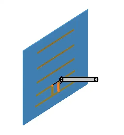

I am making the Printed Yagi-Uda Dipole Array with Balun (that is the full name). I used Antenna Magus to calculate dimensions. I am not sure how to properly connect it to coaxial cable.

Does the image below show the correct way of connecting coax to the antenna?
Orange dots are solder spots.
Printed Yagi-Uda Dipole Array with Balun Feed method
I do not have much experience making antennas.

I'm no expert on balun designs, but I think they mean to construct a folded balun, as follows. The coax's outer conductor is soldered to the same part of the antenna, but it is left on the coax, not peeled away, so the final balun structure includes a length of the coax.
(The interpretation you proposed in your question is unlikely because if the outer conductor is separated from the coax, attaching it along the length of the trace won't function any differently from a single-point junction.)
When soldering, make sure not to melt the dielectric in the coax:
  • Perform the soldering quickly, so the heat does not spread.
  • Do not use foam-dielectric coax.

  • @PhilFrost Thanks for the confirmation. I actually considered that that was what was going on, but that very site confused me with the “cylindrical tube” part (I thought they were poorly describing something more like a sleeve balun). Which isn't exactly what is going on here, but presumably close enough. – Kevin Reid AG6YO Feb 08 '15 at 17:35
    They say that because for this balun to work, the impedance of the two vertical bits must be equal, so they can have equal magnitude but opposite currents, so they can cancel. If the shapes of the vertical bits aren't identical, then the impedances will be unequal. In this case it could probably be made better by adding another piece of coax parallel to the feedline to give them the same shape, but then you are kinda missing the point of a printed balun: simple fabrication. – Phil Frost - W8II Feb 08 '15 at 17:38
  • In other words, it's a tradeoff between fabrication complexity and performance. As long as the coax is small in size compared to the width of the printed traces, it shouldn't make too much difference. – Phil Frost - W8II Feb 08 '15 at 17:41
    Use thin PTFE coax like RG316 for this, it doesn't melt at soldering temperatures. Put in a dummy coax if you're worried about balance, and also, make a last zigzag and exit the antenna in the centre, not offset to one side. – tomnexus Feb 08 '15 at 19:48
