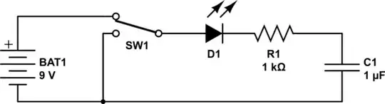

What do you mean by "circuit"? Do you mean there's a loop of conductor from one side of a battery to the other, possibly with some other conducting components along the way? How about this circuit?
schematic
simulate this circuit – Schematic created using CircuitLab
Is there a circuit here? There certainly isn't any way to follow a line from one side of the battery to the other. Each half connects to opposite plates of the capacitor, and those plates are separated by an insulator. Yet, if you flip that switch repeatedly, the LED will blink. Clearly there's some current flowing.
If we pull the plates of the capacitor apart, it's still a capacitor. It capacitance will decrease, but it's still a capacitor. Just a smaller one.
If we squish the plates into long, thin tubes or wires, it's still a capacitor. Capacitance may decrease still more due to the smaller area of the plates, but it's still a capacitor. The circuit now is looking something like this:

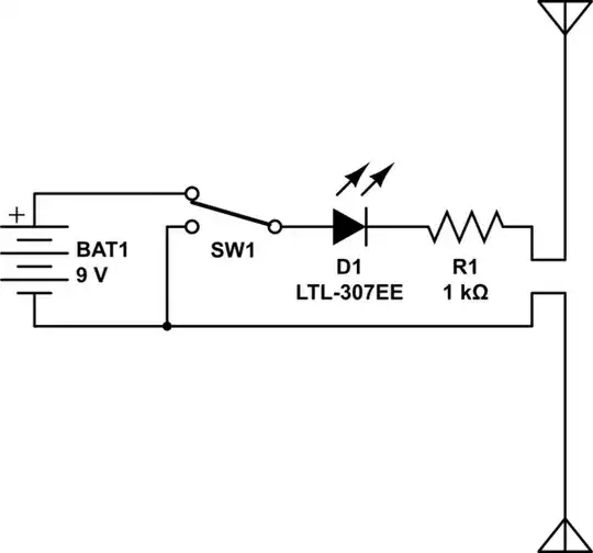

What if we now pull the ends of the capacitor apart?
schematic
Yep, it's a dipole antenna. Lose the LED and the resistor, and flip the switch a few million times per second, and you have a transmitter.
Not illustrated here is also the inductance of the antenna. All circuits have inductance, which you can realize if you follow a similar argument but with an inductor instead of a capacitor, and start straightening the coil into a straight line. The inductance decreases, but it never goes away. Usually we don't draw the inductance because it's small enough to be negligible in a simple circuit that blinks an LED.
Thus, antennas have capacitance and inductance. They also have resistive losses (unless they are made of superconductors) and radiation resistance. Putting all these together, antennas can be modeled as an RLC circuit.
