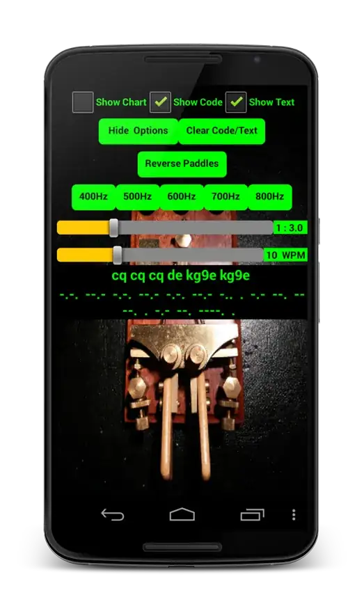

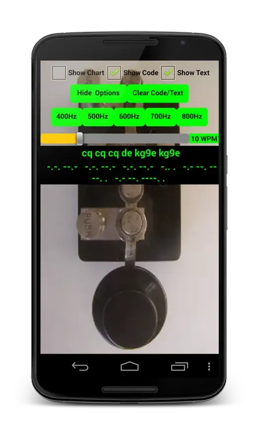

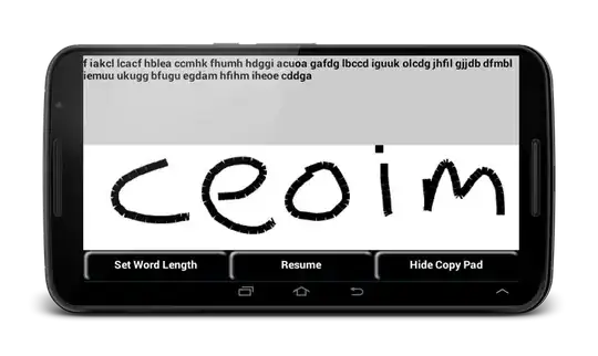

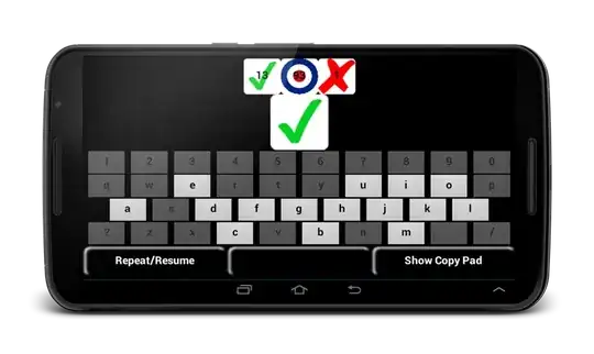

I have a couple of CW Morse code trainer Android apps that are perfect for a beginner. One is a CW Koch Morse code trainer that includes CW abbreviations and prosigns and includes interfaces for both RX and TX, the other is a Morse code practice oscillator with straight and iambic keys that translates into English and CW prosigns as you practice. Both apps are available on Google Play and the Amazon Appstore. You may find more information on these webpages:
http://www.kg9e.net/apps/AmateurHamRadioMorseCodeTrainer/
http://www.kg9e.net/apps/AmateurHamRadioPracticeKeys/
In the interest of full disclosure, I have a pecuniary interest in the above referenced apps.
